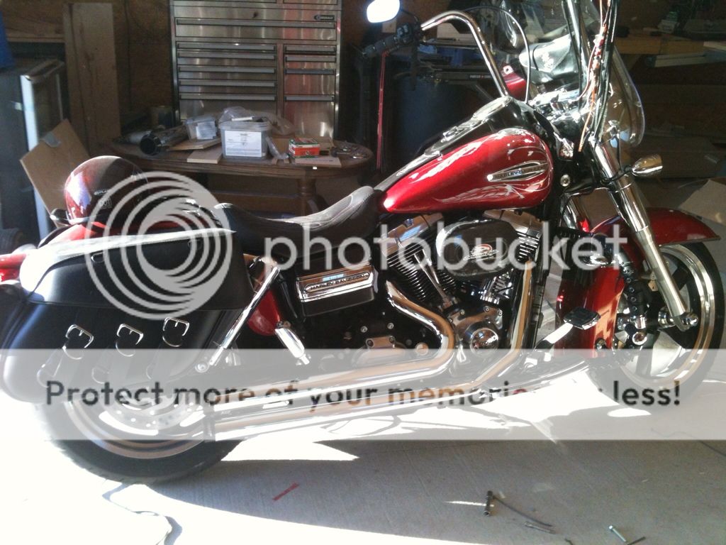

I have to agree they are loud. I got my Rinhart's on yesterday on my FLD

These are full open exhaust. They do have baffles but if you already have an open exhaust should be the same for the Rinehart's
