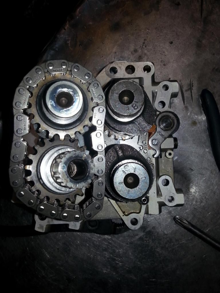

I'm putting together a fuel injected TC88 for a buddy (on a pensioner's budget). His cam tensioners sh!t the bed and took out the cams too. I have a set of stock "A" cams (carb) with a gear set and I'm wondering if they will work to replace the stock "B" cams (fuelly) I took out. Does anyone know for sure?

If you look at the case bearing side of the cams they will have "A" or "B" engraved on it. This designates it as a carb cam or a fuel injection cam. Either cam could be in a TC88A or TC88B motor depending on it's fuel system. I think it's all about how the gears mount. The A cam is splined and the B cam is keyed. I have gears for both styles. I'm just wondering if anyone has tried the swap or has better knowledge before I try to use a hammer to tune a piano. Thanks for the offer of help!

Here is a pic of the two styles of cams I'm talking about. It's not about a balanced motor.

I was thinking the cams were changed , the 99 - 00 had key-ways , 01 up went to splines I believe ?

You should not confuse the "A" and "B" labels of the cams with the A" and "B" labels of the motors.
In regard to the motors, "A" and "B" does not indicate carb or EFI. It indicates conventional or counterbalances. The "B" indicator refers to the counterbalance used in the rigid mount TC Softails.

My cams we not removed because they were worn out....Show me a set of cams that are worn out at 34k and i'll buy you dinner. Tensioners yes...worn out...Not the cams...The reason no one has tried it is because it probably doesnt work. Did you look at the numbers from the link posted before? There were differences all over the place on that chart.

I don't know anyone who has tried it (or at least talked about it) but I have read a awful lot of threads and listened to a lot of conversations about converting a EFI twin cam to carbed, I don't know of anyone who mentioned having to change the cams.
Some people never learn.... still not tryin to buy or sell anything, just trying to learn something and have a nice day without attitude. Thanks chasarms. I was thinking it could be a timing issue or something. I think the fuelly cams were changed slightly by the factory to give them that "Harley sound" at idle cuz they were "too smooth".
Basically cams are going to have degrees of duration , lift ,and overlap , these are the specifics you need to know about the cams your comparing, "A" and "B" really doesn't tell much with out specs.
The lope your referring to is the longer duration / overlap cam lobes , the more lope the less likely they make good power a low RPM's , sound cool though.
Cams target a RPM power band and compression ratio , don't see much concern whether its FI or carbed in aftermarket cam selection though , you just tune which ever your using accordingly.
