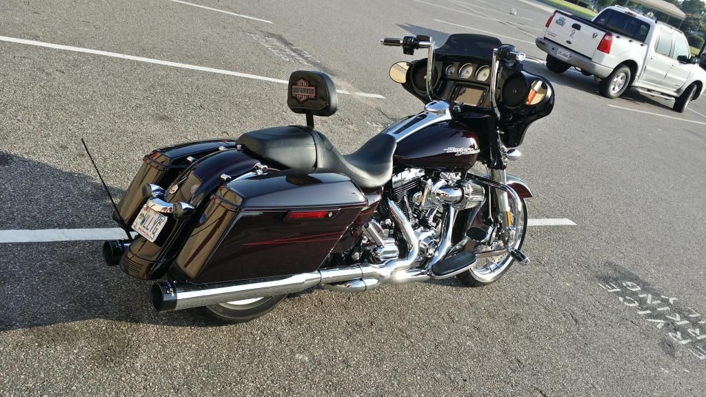

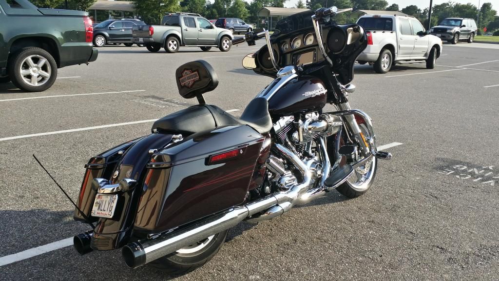

I have the Yaffee monkey bars 10" (i think) and they sit just under my Klockwerks 6 1/2" windshield. They are a bit expensive and wiring might kill you on labor. Wrist angle is good for me. Check Yaffee's web site they have photos of the bars mocked up on bikes.
