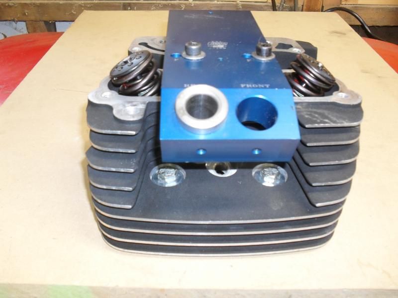

had heads a few weeks now- just got off my lazy azz and drilled and tapped the compression releases-
took a piece of mdf and mounted heads to it -
drilled after setting up jims system
spots were you get into fin ends
tapped for releases
and 1/16th hole into chamber
finished
first head took me about 1/2 hour because i was scared and had to recheck everything at least a half a dozen times - second head took less than 10 minutes-

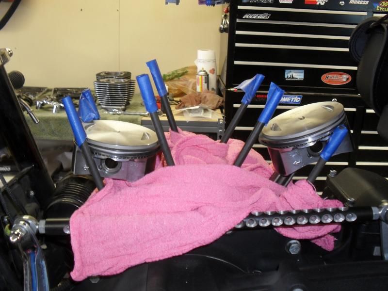

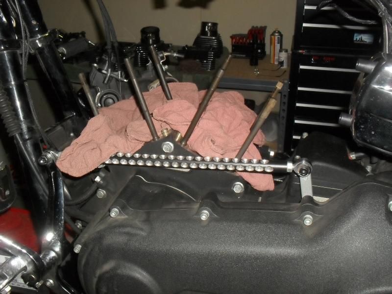

didnt have to work today- so i installed the pistons
jugs
heads
just might crack open the cam chest tomorrow:banana

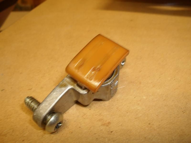

well i found a sudden fit of energy and got the cams out - front shoe has some wear
checked the crank
