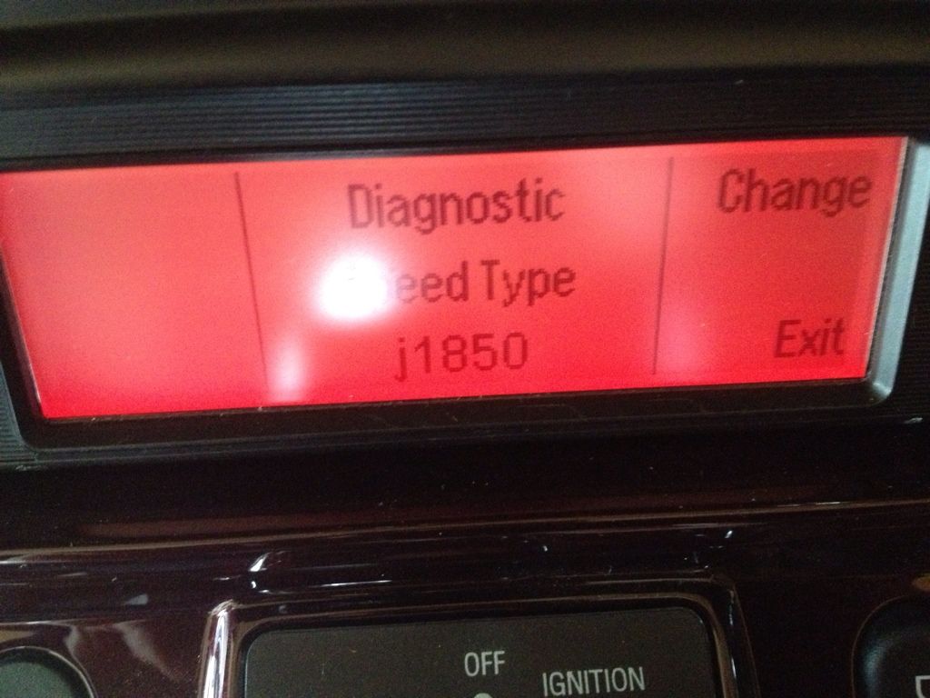

Once installed, turn on the radio. Once on, hold down the 1,3 and the "OK" buttons at the same time. You should get this screen:
Hit the up arrow five times. You should see this screen:

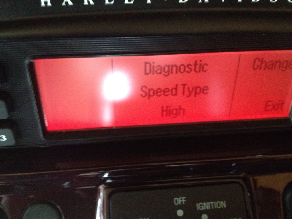

Hit the four button (beside "change") and toggle the screen to "high"
Hit the button to exit. The H-K stereo now is set to use the older style speed data input. It works perfectly. Unfortunately, this is only good if you have an '04 or '05. Before that, the stereo will still work, but the AVC will not function.
