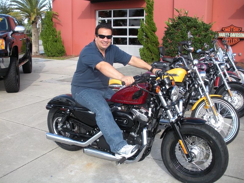

Photos of the bike when I got it (just like any other stock 48 )

Looking forward to see progress. BTW. Whose the cheesy guy on your bike? Lol:D
:rofl: that was some as**le that would not get off the bike while I was taking photos... :rofl:
