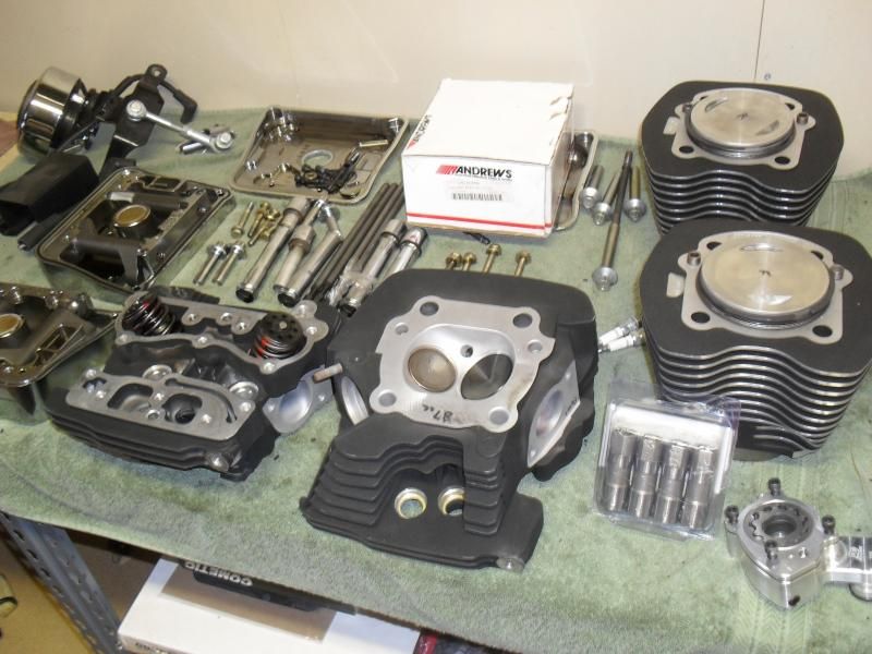

doing a few upgrades- all new leather bags -shocks-103 - so far-lol
heads with 1900 intake, s&s springs ,performance valve job done by hillside,feuling oil pump,andrews 48 cam , s&s lifters-already had roller rockers and adj pushrods- and a jims tool to do compression releases myself
hope to have the engine done by the new year -

motor is finished- also installed a heavy duty clutch spring and redline primary
oil- took out the 2'' tank lift and 1'' riser lifts- mounted a oil catch can plumbed from the air cleaner- have some new chrome for transmission(top and side covers) to install and just took apart the front caliper to replace seals and pistons -

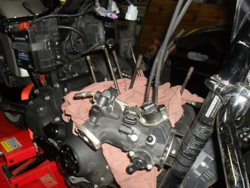

did progressive fork springs and wheel bearings on the front tire - ran the stainless tubing for the oil to the catch tank -
chrome top cover and side cover on the tranny -new clutch cable -clutch spring - tough pull so i ordered a ez pull kit - fuel filter next maybe
