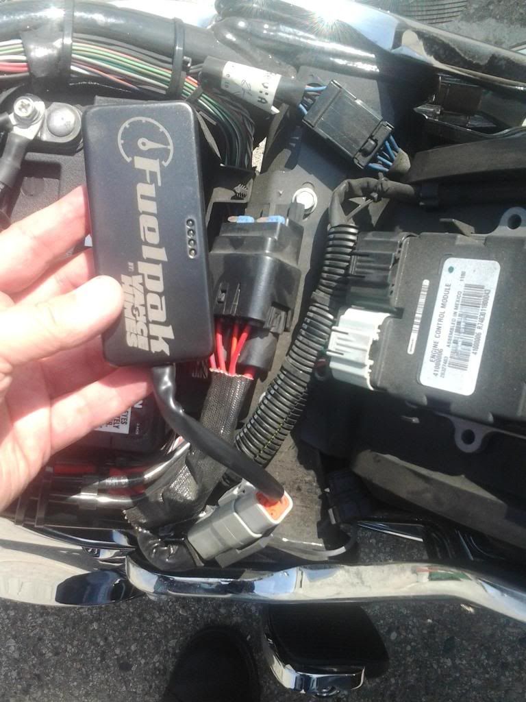

First I removed the ViED's.
Installing the FP3 is very quick, once the seat is removed. It's just plugin and start the fp3 app. The app finds your VIN number and mates up to you FP3 device. After that it does a update of the firmware. Then you do a map lookup:
Twin Slash 3” slip-ons, standard baffle. Flash map to the bike and than went for a quick test ride around the block.
RPMs were a bit high @1150-1200 …. it did hesitated on first take-off. After that it was fine.

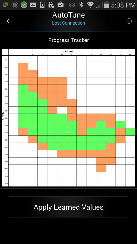

AutoTune:
First run - I connected to the FP3 device and set it for autotune. Then went on a hour long ride.
WOW. What a difference. This thing turned my bike into a rocket ship … LOL My bike pulls away fast in any gear. Decel popping is all gone. I did notice a slight engine vibration while giving it full throttle above 90 mph. Also not sure were the rev-limiter is set now.
Second run – Another hour long ride streets/freeway. Same as the first run. Lots of power and no decel popping. Engine vibration about the same. Great results, still not perfect.
Next day I rode to work, at lunch time I flashed the autotune to my bike. On the ride home I started getting decel popping …. Hummm. Maybe I should have given the autotune more time ? I will try this again this coming weekend !

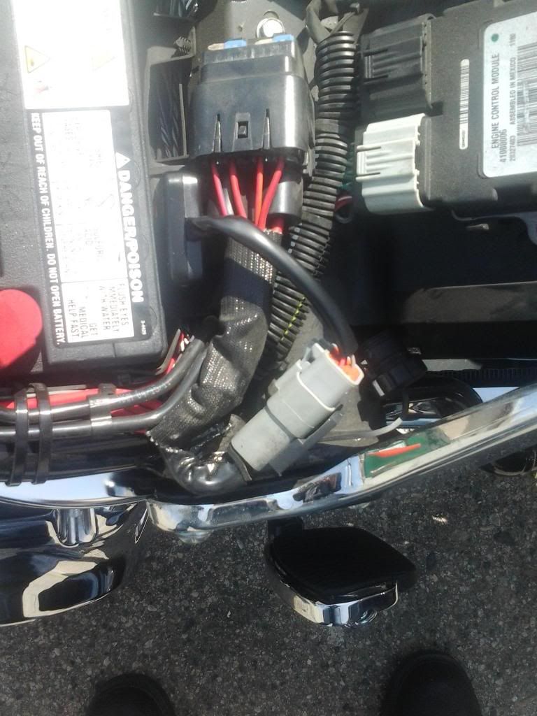

So, initial impressions are ...it's already worth every penny.
